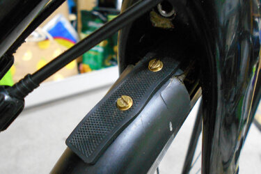

That is just what I did, from my odds and sods bag. I used a thick piece of plastic that came with some lights, the plastic that goes between the handlebars and the lamp clamp, it`s about 3" long. Just a thought for you perhaps ?
Now added photo and I have painted the screws. At the end of the day it does the job and does`nt really show.

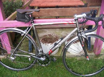

After trying to shift to both small sprokets at once, my chain came off the small rear cog and Christened my finish in another place. I must have failed to adjust the limit screw after changing wheels, so now it's adjusted, and the cable is tightened, as is the lever friction.
And after having to raise my 27mm Campagnolo seatpost several times because it kept slipping down, even with a shim, I found Fredo's original 27.2 Avocet seatpost and installed it instead. Had to pry the seat lug a bit, but now it's snug and high enough, if not quite as good-looking.
Thanks. I could do with something a little wider to actually cover the gap though. Also ideally something quicker to release than having to get a screwdriver out. I'll have a ponder.
That was the second repair on my mudguard because of the nature of the plastic being brittle. If you want quick release, something like the clips on an old cycle helmet, if they could be made to work ? I went out yesterday and my repair is OK now, no rattles. If it breaks again that will be it. I can`t complain as they have been in use since 2017.

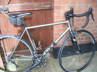

Spent over an hour fitting mudguards, then a test cycle, all this Sabath (an Ebay frameset purchase) needs now is a seat post with setback and a VNT saddle (my choise of saddles for my titanium bikes) then it will be my winter/bike for rain.
Bought a great frameset onEbay to build up with every thing from the FGP bike that i have not used in about 5 years, took it out of storage, inflated tyres and out for a last cycle, l/h shifter not working so spent some time with WD40 and oil and working great again but after another test cycle changed my mind about it and looking forward to starting useing it again.
Looks like my New years resolution of no more bikes will be broken when i build up the frameset from Ebay, what a great hobby/sport cycling is.
