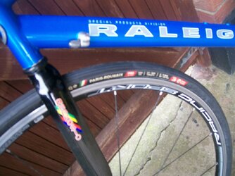

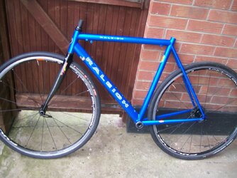

Had a few hours free this morning and thought i would take 30 minutes fit a cassette and tyres to wheels for my Raleigh project,fit bottom bracket and down tube cable stops and make a list of bits i need then cut the grass etc easy morning.
Compaired to aero bikes more traditional bikes are both easy and fun to work on but this morning i was ready to give up, never have i had a tyre so difficult to fit, bought a Challenge paris roubaix on sale and never again will i buy one, so much for gardening all my time was taken up fitting one tyre.
Good news is the Raleigh 853 takes 28mm tyres so should be a really nice bike when built, even the oversize tubes look great
