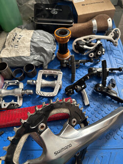

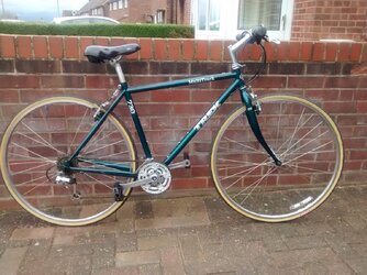

Got the old Trek out from the loft to start working out what will fit and work for it's conversion to a utility bike.
How it was;
And some of the bits for it's conversion;
Deffo need a shifter and have to see if the old bb will come out to use the hollowtec one, have some wheels (although mis-matched) and stem, bars and seat post ,will just have a front rack, basket and bag although do have a Topeak rear rack that can be quickly put on if needed.Also have Velo Orange mudguards but may need some fettling to fit and Dynamo lights.
