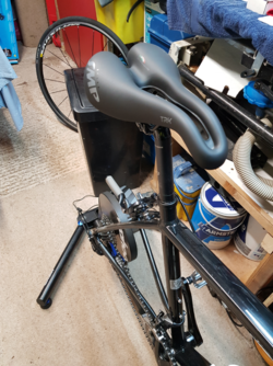

Today was new seat day, an hour on the turbo & we have a happy bot so far.
Excellent work, I'm yet to find my happy bot turbo saddle :sad::laugh: Maybe this year is the year I discover it, perhaps I should restart the search :laugh:
I was using a homemade rocker plate under the trainer last year, it helped with the numbness. I kept tripping over it in the garage it's now stacked at the back out of the way. I'm hoping the seat will be enough for comfort as I try some post covid turbo sessions.

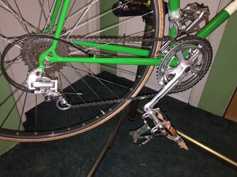

That Langdale is sure 'not your father's Oldsmobile', isn't it? Would love to see the Holdsworth when you're done.
I converted my classic build to an eighteen-speed with a Red Clover Triplizer, a 42T chainring with arms for another 74 BCD chainring to make a Campagnolo or Stronglight double crankset into a triple. Here's mine with a Sekai 28T installed:
625980

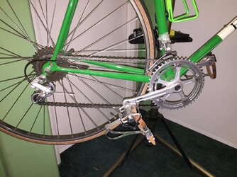

Before:
625981

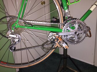

I replaced the original Sunour Cyclone rear derailleur with a Suntour V-GT Luxe to handle the wider range. After:
625984
625985
I called these 'stealth geezer mods'. :smile:
