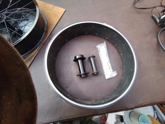

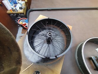

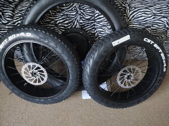

Finished building and converting 3 wheels . 2 x 20"x4.00 and a 26" x 4.00 . New hubs were used and 12g spokes ( from china as bloody expensive here in UK ) .. So built and trued . The old hub is the small one in the 1st pic , the new hub is to the left . the spoke length was 173mm ( i calculated this and was correct , I did double check and used a spoke ruler .( You can see that the wheel had rim brakes . so after rebuilding all sprayed up and 160mm discs on fronts and a 180mm for the rear .. I
