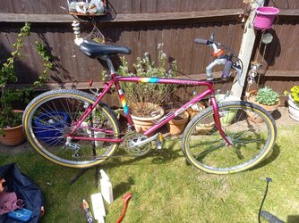

Got the Falcon out of hibernation for a check over, clean and polish

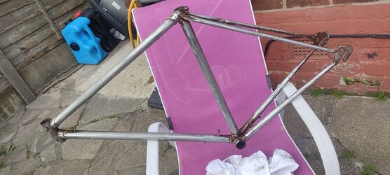

I've been striping the frame on the mystery Dawes. Interesting find during the strip down is that the serial number is on the drive side dropout despite the face I believe it should be on the none drive side.
Anyway strip down getting there on the frame.
