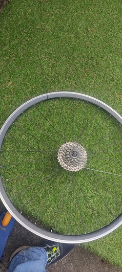

After this mornings ride I was putting the bike back in the car and ended up being distracted and dropping the bike onto the floor with the rear wheel taking the brunt on its side and a spoke snapping.
So had to swap to the spare spare, as I have two rear wheels out of action now, waiting for a 8 speed freewheel for one and now this one. Annoyingly my spare tyre is on the other faulty wheel so had to do a tyre swap too.
I'll have to get this looked at by one of the LBS.
