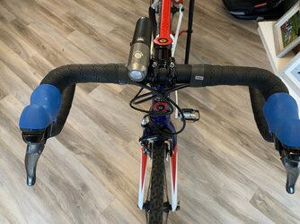

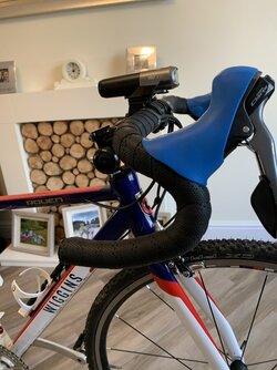

Did some pro level bar tape wrapping with the lifeline bar tape. Pretty stretchy and easy to work with.

ColinJ
Puzzle game procrastinator!
I like the bar tape, but I'm not convinced by those blue hoods! :okay:
