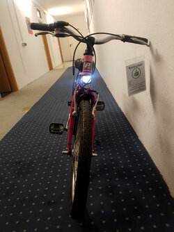

When collecting more wrecks used bikes for he shop, I found one broken one the same size as the one I was building for Tinybug, so now she has lights and good mudguards.
As an added advantage, both lights have a standlight function, which I didn't expect from fairly inexpensive lights like these.
There's still far more pink that should ever be in one place, but TinyBug will be happy...
