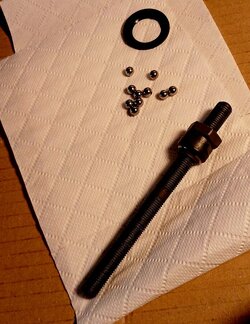

Trying to find what is wrong with this Nexus hub...
I reckon it would work a lot better if you put all of those pieces back together! :okay:
You have come to the heart of the matter right there: when reassembled, the b*gg*r wouldn't work properly.
I'm not able to invest any more time in the thing so it had been taken over by a client, who is a former marine engineer and far more capable with these things than I will ever be.
Whenever I try to fix something complicated, I always seem to find one part left over after reassembling it! :laugh:

I have that problem: I had to keep disassembling it to put bits in: my client, on the other hand, has found moving parts I doubt Shimano knew about, cleaned them and got them working again... This is why he's an engineer, and I'm a social worker.

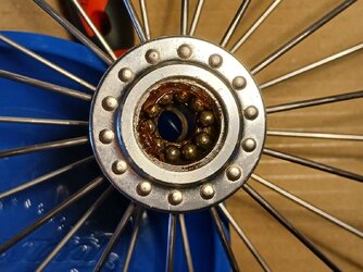

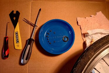

As with an earlier 2008 M3L, started with the front wheel bearings:
checked,
dismantled,
& cleaned.
Cones, seals, bearings, axle and cups were in excellent (low mileage) condition. All put back together with plenty Miller OIls WG2. Preload was set to spin freely (like a Les Paul sustain), with the wheel join (opposite the valve) sitting at 6 o'clock when it stopped. Happy with that.

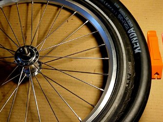

Stock Brompton tyre removed (Pedros tyre levers are fantastic),
& replaced with a new M+, which had been stored by the heating system all morning. A result - no tyre levers needed.

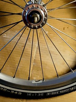

Lastly, wheel was trued, & set back in place after cleaning the fork, insides of a mudguard, brake blocks & caliper.
