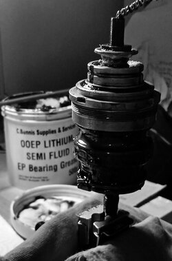

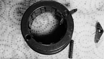

Continued the Brompton yesterday: ultrasonic cleaning of chain, etc. While drying in the sun, the BSR Sturmey Archer 3-speed hub was cracked open. Shell, bearings & cones in good condition, but the seals aren't great - grit/ sand had got through.
I made the amateur mistake of forgetting that some of the pawl springs can easily fall out. No matter, it was a laugh asking yourself: "How stupid could you be?" The hub was all back together for the end of the day - with the addition of the recommended cone lockwasher HMW147.
