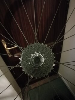

Ok I took off the wheel and the QR lever this morning.
The bit what the QR rod goes through seemed pretty solid.
The lock ring was loose, so I tightened it up with the tool... tightened it up about 1/4 of a turn, so it was definitely loose.
Reassembled it (had to get to work) but the cassette is still wobbly. Maybe not quite as much as before but still about say 5mm of wobble.
Random picture of cassette if it helps anyone...

Slick
Did you have the cassette off previously?
Mine was loose a while back and it turned out I threaded the lock ring as they can be fiddly to get on correctly.
New lock ring and attention to detail wearing my specs so I could actually see what I was doing soon sorted the problem. :okay:

You say "The bit what the QR rod goes through seemed pretty solid" assume you mean the axle, so we can discount the bearings. The only thing left is the freehub itself, so remove the cassette and check that, it's removed by a large Allen key, usually 10mm.

Cassette is removed by lockring tool and chain whip - you mean the freehub ! Depends on hub. Some just slide off, some need anything from a 10-12mm hex key, and some are accessible from the non drive side rather than drive side.

5mm - in and out - does it slide on the freehub without the freehub moving ?
Does the free hub move as well ? 5mm is alot.
Not sure I understand the question...It's difficult to see what the freehub is doing when I wobble the cassette, because the cassette is mounted on top of the freehub.
