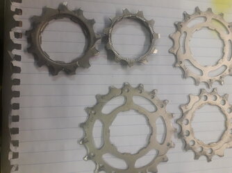

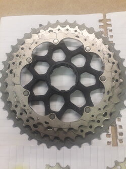

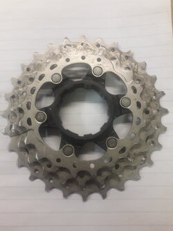

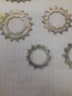

I have a 11/41 cassette that was replaced via a service for a new cassette
Can anyone tell by the photos which sprocket are worn
The logic is ...parts are now rare and maybe expensive so I'm thinking when a sprocket wears down on the cassette I use now then I will replace it with one on tbe worn cassette as I very much doubt each sprocket is worn to much
And am I also able to do what I'm proposing in theory...
Thanks

You might not be able to tell by visual inspection, unless it's very worn. All you can do is try it, but might slip if you use a new chain, but might be okay with a used one.
Not sure you can buy the sprockets individually.

I'm afraid you'll find it near impossible to get single sprockets to replace the odd worn one.
Is that merely a commercial reason that they are not sold in singles
To make you buy a full new one
I likely keep the used one and attempt uo use a sprocket from it when the new one wears
Its not for financial reasons...it just seems a waste
So long as that is ok to do

If what you were asking was possible, I'm pretty sure someone would have come up with a solution by now. It may have been feasible in the days of five, or six-speed, but with more extended ranges it's unlikely.
If one socket is worn it's likely there will be more on the way out anyway and there is a possibility that the chain would skip on a single replacement anyway.

Best thing to avoid the waste is to replace chain before you need to replace cassette as well. A chain wear tool is what most use to facilitate this.
Dogtrousers
Kilometre nibbler
Cassettes pretty much come and go as a blob, all as one even though they do come to bits. If you see what I mean.
There are mix n match cassettes where you can choose your own sprockets to get custom gear ratios, but they are expensive. Miche make some I think.

I run a mix of two casettes using the harder metal content in high use areas.
It's expensive but does mean I have a long life with it changing the chain when it's worn .
Easier to just buy a complete cassette and new chain starting again with maintenance
Ajax Bay
East Devon
As LWaB says. The sprockets which wear will normally (1x will vary with chainring tooth count and use) are those getting the most use (time x force x dirt)(mode and runner up): these are the 15/17t range.
https://www.rohloff.de/fileadmin/user_upload/3100_HG_Check_2019_10_de_en_fr_nl_es_it.pdf
For how a chain wears sprockets, see [edit] @Yellow Saddle's Cyclechat thread.
Btw buying a 'spare' cassette off someone is a mug's game. If they used it themselves, how do you know they're are telling the truth and if they haven't they don't know it's "scarcely worn". And you'll have no comeback if the chain starts slipping x00km down the road. You cannot tell by eye the state of wear of a cassette during its useful life.
