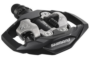

ive shimano m530 ive found these to be good as theyve got a pedal platform as well
