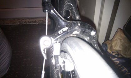

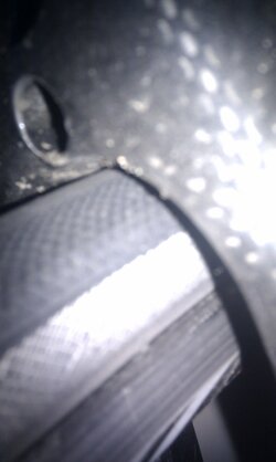

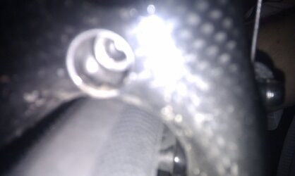

Can you post any photos of the problem so we can take a look?
K
terry_gardener
terry_gardener
stockton on tees
have just taken photos with my phone so don't know if you will be able to tell.
clearance from center of the tyre to frame is about 2mm maybe slightly less.
pressure about 105psi

Bloody ell thats tight, are we sure the bridge was put in the right place when the frame was built?
Shropshire
That doesn't look right at all ! Send it back to Wiggle once they have contacted you, as someone else pointed out stones picked up on the tyre will wear the frame and Carbon frames tubes aren't the strongest thing once damaged, could cause a serious accident !
Moss
Send it back to Wiggle ASAP! That is a serious and dangerous amount of clearance; or should I say : Lack of clearance! get it back to them!
Definitely not enough clearance. I've seen high end track frames with more, and they aim for zero. A road bike that won't take a 25mm?
It's a production F up, send it back under warranty.

i would like to say a hugh thank you to all you people.
reading the replies and also had a quick trip to the cycle shop that setup the bike and they said to send it back due to lack of clearance. he compared it to there carbon road bikes and they had 5-10mm clearance.
i mentioned that the bike should be able to take upto 25 mm tyres and he said no chance. he said that the only way you will get a proper clearance is by putting 18 or 20mm tyres on it.
thing i don't get is when wiggle built it and checked it no one noticed or just wasn't bothered by it.
i will be waiting wiggle response in the aim to send it back however i will need another wiggle box to do it.
what will happen once returned. will i get a full refund, another rhigos 3 (which according to website are discontinued) or wiggle voucher for the purchase price. i would prefer a full refund so i can buy a bike from my LBS this time and hopefully not have any problems.
