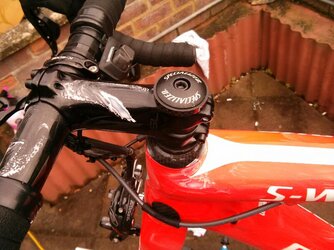

The OP ('member that?) mentioned cables wearing away paint on the stem and I think a lot of damage can be prevented with donuts on long cable stretches (top tube for instance) and protective patches on chainstay and wherever else a cable touches the frame.
Shut Up Legs
Down Under Member
Agreed, I use both of those. The transparent, colourless patches are easy to apply and definitely reduce wear on the frame, although with my Vivente tourer, I left putting on the patches about 50,000km too late, so now the poor beastie's covered with nicks and scratches. Still runs silently and smoothly, though ^_^.

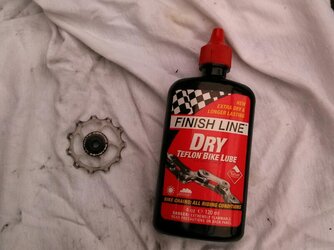

Remove the jockey wheels
Clean the rear mech and jockey wheels, remove the bearings, clean and dry and relube with finish line dry.
