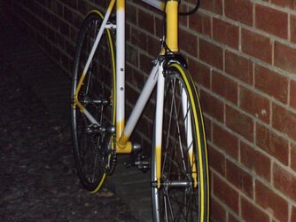

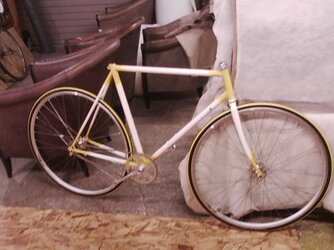

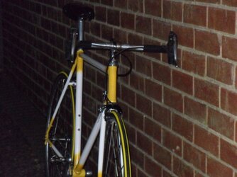

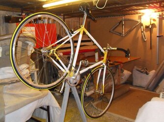

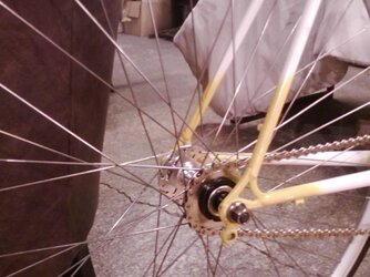

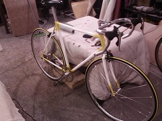

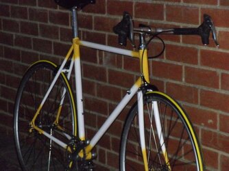

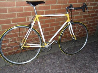

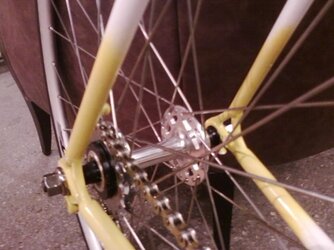

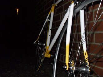

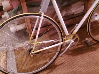

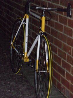

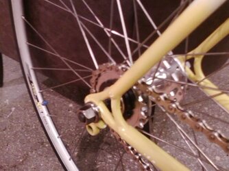

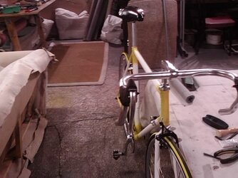

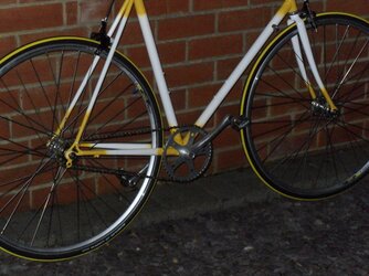

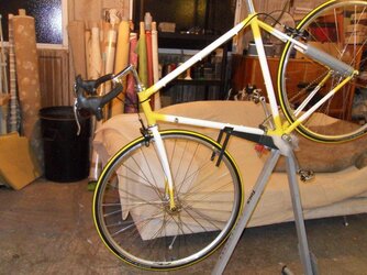

Time for an update. A few (very poor quality) phone pics.
Almost there. Just need some tape and to fit the cables and we will see what we see. I'll be changing those old Campag levers too when I get some others.
SP_A0702.jpg SP_A0703.jpg SP_A0705.jpg SP_A0711.jpg SP_A0712.jpg SP_A0720.jpg SP_A0723.jpg SP_A0725.jpg

How many teeth did you settle for on Chainring and Sprocket?
Must be almost time for a CycleChat Fixed and Single-Speed ride from North Leeds :thumbsup:
44 chain wheel and 18 sprocket. I really don't know what to expect from it to be honest. I've tried using just one ring/sprocket on my recent rides and I'm hoping it is similar. I'll soon find out.
It's looking good!

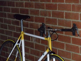

What's wrong with the Campag levers?
Not much really but the hoods have holes in and are so worn they slip about all over the place. I have seen some inexpensive Dia-compe levers online which cost about the same as new hoods. So I am waiting until I need to get something else so I can avoid postal charges. (being a tight-arse and all)

Just about done.:wahhey:
Fitted some cables I already had and some cloth bar tape that I found at the bottom of a box.
I have a feeling I won't get the chance to try it tomorrow but Sunday is another matter.^_^
Err? Unless it's raining !

ul prob find (unless its very hilly )that 44*18 is too short and spinny ,iv got the same on as a ss ,but if i flip the wheel it 44*16 and its much better ,doesnt sound a lot but afaik i tooth less on the back equals 3 more on the front ,,,maybe hahahah:thumbsup:
some guys run crazy gears ,,i know a guy on a fixed gear forum up here runs 52*14!!!!
