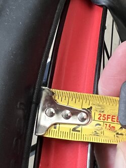

TESA 4289 tape is ideal for Tubeless. Available on Amazon, Ebay & the like, and much lower cost than bike brand versions.
Width - you dont say where your 23mm is measured on your rims.
FWIW I've used 21 mm wide tape on H+ Son Archetype which are 23mm external and on Kinlin XR-26RTS which are 24mm external/19mm internal .
You just need to cover the rim bed and a little way up the sides.
Before applying the tape I suggest cleaning the rim bed very thoroughly with Isopropyl alcohol to remove any greasy finger marks

Hi sorry my rim is 23m - 24m full length loads of people and Muc off have said I need a 23-25mm tape but I thought I would ask in here because would not the 23-25mm hang over or would they be saying that because of the little dip in the wheel when putting the tape on

+1 for TESA 4289 tape, its much better than Gorrila tape, Gorrila tape woks but is terrible stuff to remove, make sure the tape is right across from inner wall to wall a bit up the sides is OK but it's not a must.

As a rule of thumb, to pick the right width of your tubeless rim tape, you need to measure the internal width of your rim. Any tape that is that number plus or minus 1mm is good; so, in your case, 22-24mm wide would work (provided the number you gave is the internal width).
