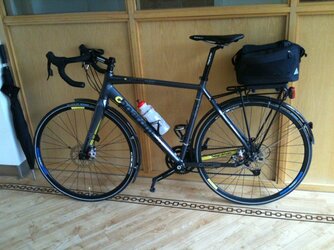

I went with the narrower SKS Chromoplastics. Hopefully the pic has attached below. That was from the days of Schwalbe. I don't think it looks too bad for an all-purpose machine.
Note the missing stay from the front guard. You can lose it or try some creative bending to get it around the disc brake unit.

Cheers, think i have your bike on here elsewhere, looks good!
I was looking at the SKS chromoplastics myself, after seeing yours and others on here
