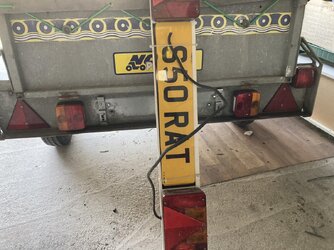

I replaced the 7-pin plug earlier, as part of the problem with 'tail-light bulb' messages might be the cable moving in the plug, as the one that was fitted had no internal clamp
It's going to be a 'trial & error procedure'
There's still an intermittent fault, so I think I'll have to rewire the entire trailer, & replace the dodgy off-side tail-light
I've done it earlier this afternoon, using the 7-core from my lighting board, that's only been used twice since, pre-2010!
When we bought the (short-lived) Touareg, & when I bought my trailer (tested, & taken, just in case its own lights didn't work)
I've not tried it yet, as I was in glaring sunlight, & was getting a headache, so once it was all together, it went back in the garage for now
EDIT @ 17:46
I've taken the trailer out to the Kodiaq, hitched it up, barring a slightly embarrassingly transposed brake & tail-light connectors, in both lights:blush:, all works
The lucar connectors were just swapped over, all okay now
However, Sods Law dictates that something will not function correctly, when I first use it again
EDIT; Monday 3rd @ 08:53
There's a very short 7-core on the light-board now
That's the next job, after finding some side-reflectors for the trailer (Indespension - Leeds, didn't have any last week)
EDIT @ 17:46
I've taken the trailer out & tried it, barring a slightly embarrassingly transposed brake & tail-light connectors, in both lights:blush:, all works
It all works fine :okay: ^_^
Despite some deliberate bouncing over speed-humps/positioning (when viable) the Kodiaq, so that the trailer-wheels hit potholes
No warnings on the instrument panel about faulty trailer lights, for any bulb
It ought to be good for a few years, with completely new wiring & light-units
