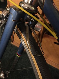

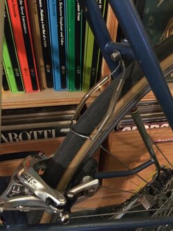

Fitted the tire-savers given to me by a generous member of another forum, or as he calls them, 'Sticker Flickers':

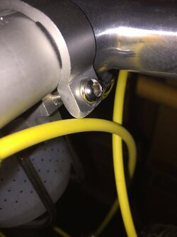

Rounded off the corners of my bottle cage bracket so I could get the angle I wanted without cutting into the brake cable:

May be wrong but when we used these 'tub savers' in the 50's and 60's we fitted them the other way round -- resting on the tyre with the flow as it were - to avoid the possibility of the device getting dragged into the tyre and causing problems.
