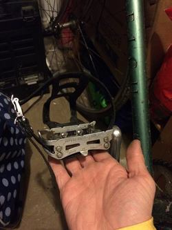

Fitted the toe straps to both of my bikes today and planning to go and test the straps on my road bike shortly! Another thing to get used to as I spent ages getting used to toe clips without straps, now ready for the next step!
