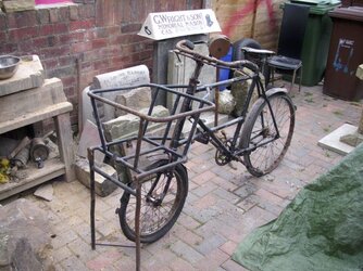

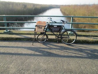

thegravestoneman
three wheels on my wagon
What looks like part of the frame in the background of your pic appears to be in need of a bit of a polish and wax? :eek:
:biggrin:
Bl**dy cheek I had just spent two hours polishing that :smile: but seriously it's a 7 shape seat post that's original to the bike which is now 55 years old and been stored badly for the last 25 years ". but one thing at a time, the main thing is it's rideable. I think I will get it blasted and powder coated in black eventually. View attachment 17536 View attachment 17538

ok that didn't seem to work, try the pics again
