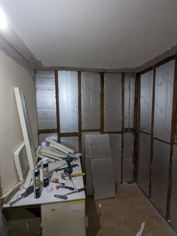

Not bike related, but just finished removing all the external stud walls on my new to me house (this is my first house, one I never thought I'd be able to afford), it was built in the 1950s and doesn't have any insulation in the first floor timber frame. Tomorrow's job is to put PIR insulation boards into the framing and then start plasterboarding walls back up in time for the plasterer to come and skim next week. The photo is of my office space.
This is the first job in a long list of jobs as the house is a bank repossession and is in terrible condition internally and externally, the render on the lower half of the building has flaked off and causes some damp issues, there are holes in all the walls internally where someone has kicked them in and the roof needs work, particularly around the dormer windows where the flashing is in terrible condition. Oh and large parts of the brickwork need repointing. After that I'll start on the garden (front and rear are approaching rainforest), the concrete driveway is cracked and uneven and the external garage needs a lot of work before I can proceed to do what I want which is to turn it into a workshop.
If the rooms aren't too small, place foilback insulation board(Celotex) between studs, leaving 25mm air gap to wall. Ensure tight fit by using insulation padding tape between all edges. Then apply another top layer in front of studs of 25-75mn insulation board in large sheets. Seal all gaps. Use expanding foam for all tiny gaps. Being super diligent in insulation, reducing airflow will ensure low energy bills

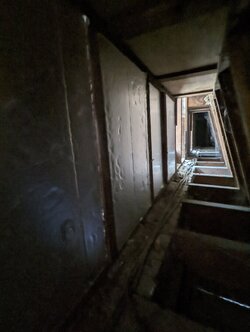

Today's fettle was to fit Celotex boards between the studs, not always able to leave a 25mm air gap to the wall as the studs come right down, but was able to leave a small one and the whole upper floor is vented below. Tomorrow's job is to fill the gaps with foam and to put foil tape over the joins to ensure the barrier layer is complete. Saturday will be plasterboarding over the top ready for the plasterer to do the skim on Monday.
The overlapping front insulation is to stop cold bridging from the studs to plasterboard. I know its wood but it still conducts heat or cold . I used a thermal imaging camera to detect any cold spots on my new build before fitting plasterboard. I also did the sliver of tissue around all door and window reveals in windy weather. This exposed a few tiny drafts where the builder had not fitted the cavity insulation thoroughly. Some minor remedial retrofit action sorted it. The next best job was fitting MHVR which balanced all rooms to within 1 deg C, even on the colder north side of the property. MHVR eliminates moisture/condensation issues when you properly seal up a building. Clean, dust free and humidity reduced warmed air
