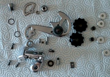

Since a lighter 700C wheelset replaced the 40+ year old touring 27" set, and with better tyres, the 531 has been transformed.
Latest fettling:
  1. Reset the angle of the Sakae handlebar, which brought the brake levers slightly higher.
  2. Same for the B17 - now doesn't have that slight feeling of trying to pitch you forward. Seat post is a twin bolt J.P. Routens - originally on the bike - a cool design that's really easy to adjust.
Simple work - but made a fair difference. Test ride this morning - all good.
p.s. Kudos to Suntour for the mostly unregarded ARX GT derailleur - fabulous gear changing. Another original component, date coded 1983 - overhauled last year.
