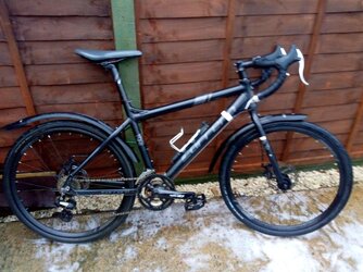

I wonder how a drop bar set up would mess with the geometry?!!
All new improved geometry, honest guv'nor!:rolleyes:
cyberknight
subway hybrid with a bodge drop job
