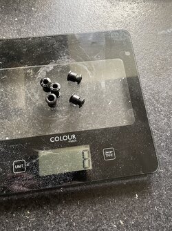

Damn! The 11g single-length titanium chainring bolts I’ve just put in are heavier than the doubles I’ve taken out!

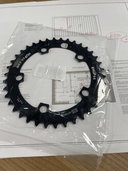

I’ve fitted this 56g 38T n/w chainring in lieu of the 143g of 50T/34T that are now residing in the shed.
I’ve saved only a measly 83g by removing the SRAM Red front mech - that’s the problem with having high-end kit to start with!
The front mech hanger is riveted on, and it’s a bit of a one-way street to drill the rivets out, so I’m keeping that on 🤔

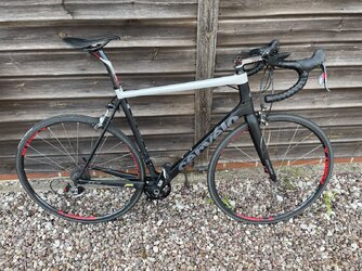

So I got as far as fitting the new chainring with the new heavy bolts yesterday, and I’ve removed the front mech and the chain (which I can afford to shorten now - another little saving which you can be sure will be documented).

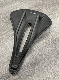

The eagle-eyed among you will notice that I’ve also swapped the saddle for this rather sexy sub-100g AliExpress model:

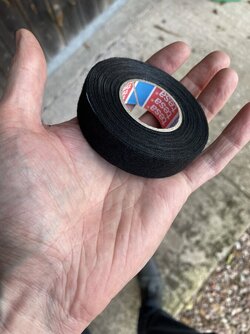

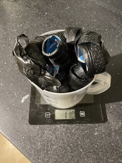

This was nice bar tape, but at 110g(!), it had to come off.
I’m replacing it with this stuff:
