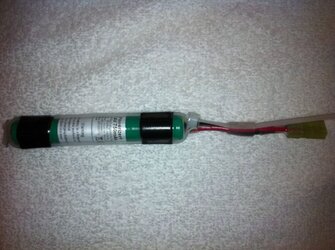

I run seat post battery conversions which have a larger capacity than standard so my systems could not be used as any meaningfull comparision. Based on what people get with the standard battery I should get somewhere in the region of 1200 to 1500 miles on average, possibly more but do not know as I have never had to recharge the battery yet :wahhey:
My larger capacity battery however still weighs less than the standard kit as it does not feature the case holding the batterys, or the bottle cage mounting used most commonly.
I have attached a pic of the seatpost battery I use. The battery is shrink wrapped to ensure its water resistent and then black tape is wrapped round the top and bottom the diameter of the seat post and it simply pushes in place with friction holding it in place.
Never had an issuse even on areo seatposts like the Venge or with the vibration on MTB conversions.
If your still concerned a cork at the bottom of the seatpost adds extra security.
