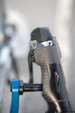

I hope V for Vengedetta doesn't mind me nicking his image, but this shows the sprint buttons installed on V's Venge.

The modding is mainly adding stuff to the battery and extra shifters?
The vast majority is hiding the ugly arse battery inside the frame, doing in bike charging and shifters. On occassion you will see lights powered from the battery and things like phone chargers. These latter mods however are only really feasible after the seatpost battery mod, simply because when you do this you have the option to increase/decrease battery capacity to reduce the need to charge for longer periods or to reduce weight further.

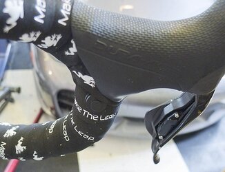

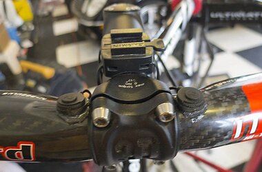

Though I would post some custom shifters to add to this thread,
disclaimer - not my work :becool:
1) unoffical sprint buttons. (I run the Shimano buttons myself)
2) Bar top shifters (cat eye buttons)
3) hand bike shift buttons
