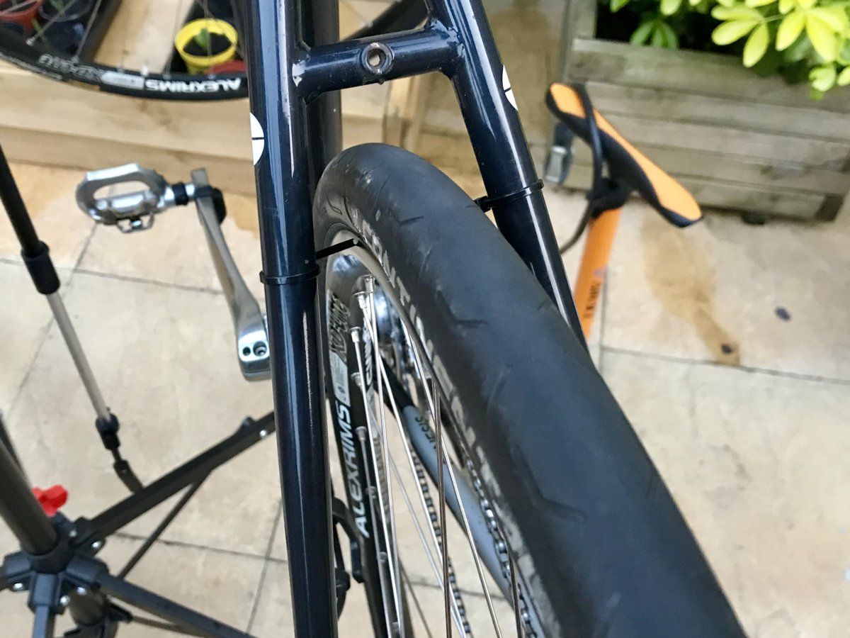

Bought a spoke key and had a go at truing my rather wobbly back wheel using the ‘cable ties attached to frame method’, leaving the deflated wheel in the bike frame.
Really very f’ing pleased with the result. No visible wobble or inconsistent sound from the cable ties. Was so close to buying or fettling a truing stand... figured it was worth a go though despite some stuff I’d read against truing a wheel whilst in the frame. LBS on charges a £10 to true if I screwed up so no big risk.
After an a couple of hours this evening in the sun with a glass of wine I have to say i think wheel truing is a perfectionists dream... think I was verging on OCD by the end of it.
Question though - whilst there was a little loosening of spokes, there was far more tightening overall. If I end up having to straighten the wheel again sometime in the future (hopefully not for a long time), would it be advisable to loosen everything a little first to lessen the risk of over tightening? I don’t want to snap spokes or end up with an egg shaped wheel...
Thanks for any advice!

I let the missus know it too... many times! I'm sure it wouldn't cut the mustard if a pro were to inspect it tho, but I can't spot or hear any wobble or high spot so am happy. I took my time, only a quarter turn max at any time... spin the wheel, re-check, repeat... thought I had it pretty much spot on a couple of times and then made it worse again! Got there in the end though.
