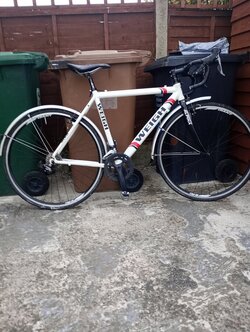

I think i have found the cause of my knee pain as although i set the saddle height and reach on the weigh cx build up right i never thought to check the saddle setback from the BB.After some measuring i worked out it has a really steep seat tube and it meant i was only at most 2 cm behind the BB from the saddle tip rather than my usual 4-5 cm and that is with the saddle most of the way back on the rails .
Options are to get a layback post and a shorter stem but i am undecided as i dunno if it would look odd with the height of the post as is anyway ? the other option is to strip it for parts as most of them can be used as spares or for another build as the frame was a freebie anyway .
