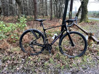

Tada! In its natural habitat! This morning its natural habitat was by the side of the road, trying to stop the bastard mudguards rubbing. Also the seatpost is a pain in the arse to adjust with a multi tool and the gears weren’t set up right, but that’s probably my fault.
I’m recovering from reactive arthritis so there was no chance of a proper ride anyway so a short fettle was good enough for this morning, need to order some proper mudguards though, clip ons were a bad idea.
This is my first GRX bike, is there any cable adjusters anywhere? I can’t see how to index the gears, luckily they came ok but it won’t last.

There should be one on the rear mech where the cable enters(item 11);
https://www.sjscycles.com/Drawings/Shimano/Shimano_GRX_RD-RX810_Tech_Doc.pdf
The front is a bit trickier as it's adjusted with a small hex nut where the cable is clamped.
This is the parts diagram for an 810 mech but it's mostly the same for all newer front mechs (adjust screw is no 2); I think some older and lower spec ones are slightly different.
https://www.sjscycles.com/Drawings/Shimano/Shimano_GRX_FD-RX810_Tech_Doc.pdf
Hope this helps :smile:

Awesome thank you, I wasn’t sure about the rear, much slicker looking than any Shimano mech I’ve seen before. I’d assumed the front mech just wouldn’t have one so this is a happy bonus.
