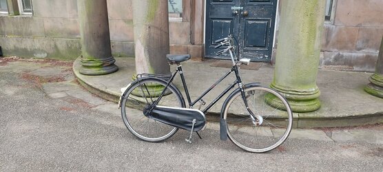

Yesterday was busy though, I went to collect a bike from a Facebook Marketplace deal and ended up coming home with two, the seller wanted rid of a Claud Butler MTB from the late 80s I think it's the exact same frame as my Holdsworth I built into a gravel / adventure bike, he gave it me for free so I couldn't say no and took it to my BiL for him as I am out of space.
The bike I went to collect and kept was a late 1970s Gazelle Trimsport with a step through frame. Bit of tightening of bolts and some air in the tyres and it got a spin around the park. A few more tweaks and checks and I took me to Lidl for supplies.
List of jobs is manageable so far.
New tyres (they are 37-590)
New tubes
Couple of new spokes in the front.
Brake hub service / clean.
Replacement chain guard sourced and fitted
Look at upgrading the front light to LED & standlight
Find suitable rear light
Possibly change the rear sprocket to make it easier on the knees
With both bikes it close me about 67p per kg of steel.
