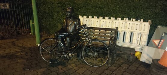

Been working on the saga that is the Gazelle again today. It's certainly lived a life over the last 40 odd years so getting things apart is problematic.
I have removed the chain guard for now as it was broken and replaced the two missing spoke on the front wheel. This now needs some truing but currently doing regular sprays of wd40 on the nipples.
I have fitted a 20t rear sprocket upgrading from the 18t it's a heavy bike and it's not flat in my town.
Fitted the marathon plus and new tubes.
Cleaned both hub brakes.
Will probably fit a new chain when I source a new chain case but the current one seems serviceable.
Need to work out the gazelle bottom bracket.
Finally need a new non driveside but for the rear axle as the existing one with pretty much stripped.
Not even had chance to bring my £15 rod brakes Portuguese bike in for an assessment yet to it out in the rain.
