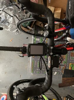

Whilst I was ordering the essentials, I also ended up ordering a new set of handlebars. The old Kona bars are not bad, but the curve on the drop is a little tight and they're not the comfiest to ride in that position. I was also hankering after more flare on the drops, the Kona comes with a smidge over 12 degrees and I wanted more. So I went for a set of 50 cm wide Salsa Cowchipper's, with 24 degrees of flare and a much nicer shape in the drops. Curiously they also have a shorter reach, which brings the hoods a tad closer to me. It didn't take long to fit them and I left them unwrapped for now while I dial in the fit. Riding around the estate though whilst bedding in the brake pads, they felt absolutely lovely, the extra width and flare over the old bars has really improved the low speed handling. I'm looking forward to getting the bike out on a longer ride now to test it all out, just a shame the current weather is really not conducive to riding in the forest.

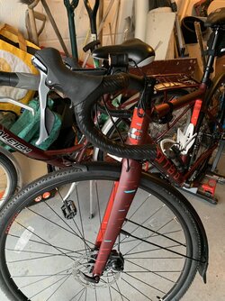

Bit more than a fettle but didn't feel it warranted its own modification/rebuild thread.
Fitted some Kona P2 forks to my Rockhopper to replace the knackered XCM'S.
New rear rotor and pads.
Fitted the Conti contact cruisers, these are the easiest tyres I've ever seated, took literally minutes.
Pannier rack to fit tomorrow when my mate drops it off.
Wouldn't have minded if it looked a bit 'hacky' as the plan is for it to be an all purpose do anything bike but actually think it looks alright so far.
It may end up with some different bars at some point too.
Before and after pics.

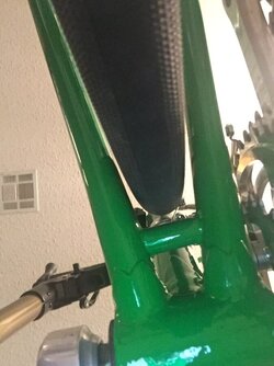

Son no. 2's racing the Guido Reybrouck Classic in Belgium in March and I sorted out the wheelset he's going to be using this evening. We've gone traditional and probably against-the-grain as it's a cobbled race, possibly wet and with crosswinds.
In the parts store was a new 38mm Superstar Components wheelset in red, now with GP5000 25mm tyres and latex inner tubes plus a Junior cassette.
Why shallow-ish aluminium rims and clinchers? It's a lumpy race near the Belgian coast in mid-March. Likely to be wet and/or windy. With cobbles. We have to buy his wheels, so carbon ones on cobbles could mean an expensive day out. Also, he's only 53kg so any strong winds make life hard with deep section rims. And the wheels are mid-weight, which will help with the lumpiness with any carbon wheels we have being 50/60mm depth. He's selected GP5000's for their grip rather than the Pirelli's he uses normally, with latex tubes losing weight and rolling resistance. It may help. But he also may get absolutely battered by the competition.
If racing happens on Sunday he'll give them a shake-down test. If not, we'll find another way. Photo once they're on the BeOne, although he'll be racing his Cervelo S3 (with a NeilPryde as back-up) since the BeOne isn't UCI approved and training on that next week whenever it's dry.

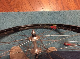

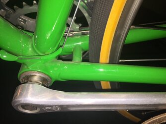

Today I finally finished refurbishing my old Specialized training wheels. I started by removing the 35 year old tires - Specialized Turbo R 25c that actually measured at 21mm. I'm saving them as they are still good. Then I replaced the dinged front Mavic MA40 rim with a new Mavic Open Elite.
631576
Trued up and centered the front, and re-dished and centered the old rear MA40. Took some steel wool to the stainless DT straight 14-gauge spokes, which got a lot of old dried crud off and shined them up well. Took a brass toothbrush to the old ferrules on the inside, oiled some of them, then cleaned up and buffed the inside track. Replaced the Specialized plastic rim tape with cloth Velox, 10mm front and 16mm rear. Mounted new 28 mm Specialized Turbo Cotton tires, 260g, using 85g Vittoria Latex tubes (pink!), and Stan's sealant right off, for our goathead-rich environment. The new 28s are a close fit on Fredo:
631578 631644 631645
Had to deflate the rear to get it in. Pumped them up to 80 psi front, and 85 psi rear. Can hardly wait to try them out!

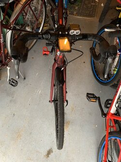

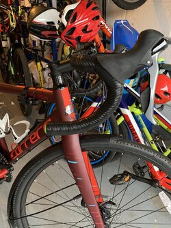

Removed the stock 400mm Carrera bars off my Vanquish and replaced it with a set of 380mm (400 as sold) Deda Zero1 bars then did the best wrapping of tape I have ever done, it’s carbon effect and a little thin so will see how I get on with it, may replace It for something thicker; will take some pictures tomorrow.
