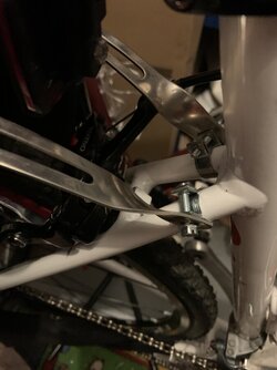

This was my brake pipe pannier rack hack. Two clips from the automotive shop for £1.50 in total. As you tighten the screw it squashes the hose bit into a tight circle and clamps down, same job as a p clip.
you might want some (white) electricians tape between clip and frame to stop it scratching it, especially if the screw works slightly loose and it moves a little.

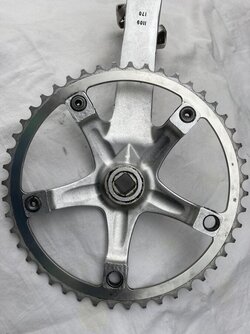

I have a fettling problem, I discovered I have loose chainring bolts . It’s a Stronglight 2000 track chain set with captive back nuts for the bolts. The Problem the back nuts are no longer captive , there is no way to grip them . So any suggestions that don’t involve destroying the chain set or chain ring.
