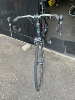

My 80's Clamont moved into the 90's and got a set of Shimano 105 8 speed brifters that I had spare.
The only slightly challenging part was finding a front derailleur to work with the brifters.
I ended up using a spare Shimano RX100 derailleur from another project which had the shorter arm (between pivot and cable attachment point) and a slightly larger clamp.
I made up a shim from scrap metal which sorted that and it was right to go.
I still love my downtube shifters but as this is my quickest bike it seems fitting to make my gear changes that little bit quicker.
