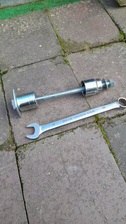

took the new rear wheel for the commuter to the lbs so they could true the old rotor , i tried with a spanner but made it worse as i need a proper tool to do it .

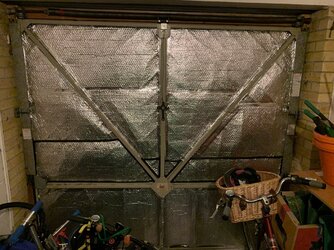

Second fettle of the day, insulate the integral metal garage up and over door.
