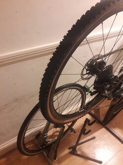

I probably should have done a fresh install but after the weekends resorting to a tube in a tubeless tyre on the gravel bike, half of the tyre was still seated. So I inserted sealant and it seated instantly with a track pump, no mess. Then it started to hiss from the stem. So cue peeling back the unseated half of the tyre and adding fresh rim tape; and reseating the tyre. At first with me probably not getting the rim tape smooth enough it wouldn't seat, so I resorted to CO2 cannister to give it that extra whoosh to get the tyre over the hook in to the bead. That worked at first but a few minutes later was that hiss again. But having got the tyre over the hook I just kept at it with the track pump inbetween spins of the wheel and the hiss stopped. That all resulted in a little mess. I had to do the same with the road bike's higher pressure tyre last night but it was much more messy as both sides needed seating.
Yip I definitely should have done a fresh install. The tyre although pumping up solid the valve is leaking at higher pressure. I'lll try taking it out cleaning it and the rim bead and applying some electrical tape instead of rim tape for that section (it worked before and was good for over a year. If that doesn't hold over night it'll be a new valve and a fresh install 😐
The road tyre I fitted the night before seems to be holding air at least.
Success hopefully I put some electrical tape in and cleaned the valve and put a new rubber washer on it. The valve leaked at first again but the cleaned stem/washer seemed to attract the sealant to it so it quickly sealed.
