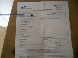

Just a mater of interest if anyone changes there own brake pipes, Fitted new brake pipes last year and made the horrible mistake of buying a roll of brake pipe from an auction site E some thing under £10 for 25 feet, anyway took car to MOT and it failed because of rusty brake pipes.
Pipes i fitted actually 11 months ago looked and was described as Copper Nickel Brake Pipe Hose but dont believe it, not worth fitting even if it where free pay a bit more and fit quality pipe once and forget about it.
Bit upsetting to have to do same job less than a year latter and having only driven the car less than 3,000 miles and having to book a retest and pay another fee.

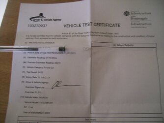

You are so right Andy, Actually after reading your post went out cleaned both so called corroded/pitted brake pipes wiped them down with oil look ok but they are still the pipes that tester said where corroded/pitted, Here in N/Ireland there is about 4 months waiting list for MOTs and you can only book a test 3 months before a vehicle is due a test? but retests are so easy well car had failed test at 12 noon and got a retest at 18.45 and passed same day same brake pipes?
Have known guys booking tests and driving 70 miles to a test center because theres been an appointment and another 70 home.
Will replace the pipes first time the weather looks like it will stay dry but no hurry now.
Only my view but cheap pipes on an auction site are not worth fitting even if free and as you said Andy it seems to depend on who is doing the MOT?
Maybe just unlucky in the morning or else very lucky that evening?
