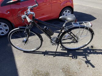

Hi Phil-b, I bought and fitted the Cytronex C-1 kit to my Hybrid Claude Butler which I have owned for twelve years now. I spent £1k on the kit and when it arrived found all parts are of a high quality. It has six power levels which make easy work of the Derbyshire hills and it is completely road legal here in UK. Cytronex do offer the kit in America which is higher powered for their roads you can purchase this kit in UK but you will need to sign a disclaimer when you purchase the USA kit.
