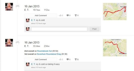

Since I put grease in the hubs on Saturday, both my husband and I have blitzed our normal times & speeds despite the fact we are taking it easy on the roads because of the icy conditions here (no snow yet - due tomorrow). We did 45 miles on them on Sunday and I even got a compliment from my OH regarding his bike, saying it felt smoother & quieter than it has ever done. Yesterday's 36 miles on icy roads (mostly back lanes though I did bale to a dual carriage way for one nasty section (inconsiderate motorist defrosting their car with water on a 10% gradient makes an ice-rink even I have no wish to venture anywhere near to)) showed 7 "cups" on strava (now only showing 6 for some reason) including 2 fastest times for me since starting to use Strava back in November. Now I don't race - that is madness for me with my asthma & bad leg, not to mention the panniers I am usually carrying.
My averages are back up by 2-3kph without me even trying and it feels easier, the wheels feel sooooooo much better that I personally would say strip them & grease them even if they are the stock wheels because the worst that can happen is they improve! You will also get to see exactly how true the person on ebay was being and he will be able to practice on wheels that don't cost much rather than newer wheels later one. We also found that in my husband's hubs the qualtiy of the bearings was much lower than those in mine - the bearing in his hubs were pitted & rusted where as mine despite having the same amount of crap in them and having done twice the distance were actually fine. His front hub had also been overtightened so the wheel was grating a touch and not spinning as freely as it could have been, mine rear was the reverse, it was too loose and now has a knock that I can't cure. Ideally I need to replace the bearings & the cones in his hubs, but despite that just having cleaned them and packed them with grease, they are considerably better than they were ever even new.
