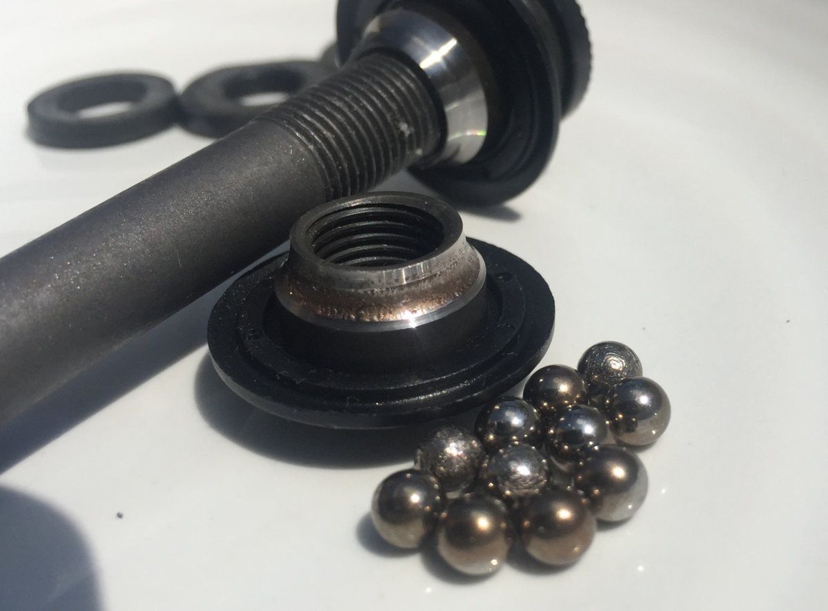

I've recently been experinceing brake judder on my front wheel (disk brakes). I couldn't find anything wrong with the brakes - disk not warped at all, pads and clearance seem okay. So I dug deeper.
Front wheel is spinning freely, but perhaps not quite as freely / long as I'd like, although still feels relatively smooth when spun by hand (holding the axel with no weight or load on the wheel).

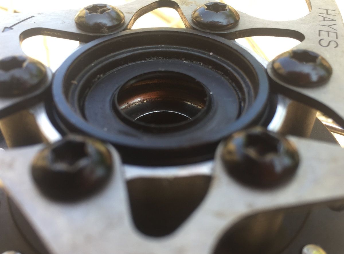

So I wondered if it could be to do with quick release. Took that apart - again all seemed okay. So had a peak inside the hub and saw the state on my bearings on the disk side of the wheel. On the far side, the grease was still clean, and the bearings shiny and smooth, but on the disk side everything was kind of copper coloured. On closer inspection, the bearings are badly pitted, as is the collar / smooth part of the bearing nut (sorry, don't know what to call it). I think the copper colour has come from where the surface has worn away. The inside of the hub doesn't look too fantastic either.

I've have a few questions...
1) Is this likely the cause of my disk brake 'judder'?
2) What is likey the reason for the badly worn bearings? Crud/grit getting in? Nut too tight? Too loose?
3) Should I just replace the bearings and nut? What's the hub / bearing nut called? Do they come in standard sizes?
4) Or do you think it's time for a new hub too (I'd probably get new wheels - they where stock with the bike 4 years ago - Alex XD-Lite rims, shimano hub so not expensive.... upgrade?).
5) If I put back together and ride for a day or two nothing will explode or kill me right? ;)

The internal race(cup) on the last photo looks a bit pitted too. That you can't fix - unless some fine emery cloth can smooth it out. The cones (you called them nuts) can be easily replaced and look badly worn. Your LBS should be able to help. If the hub is shimano you could source the cones online. New ball bearings are needed too. You've clearly not been looking after the bearings and I suspect the other wheel may be just as bad. You might be lucky but you may need to get some new wheels.
I replaced the cones and freehub on my Alexrims rear for £20 recently but it took a lot of effort to track the parts down. You're not risking anything by putting it all back together with fresh grease. It's going to be better than before and will last until you decide what to do.

The internal race is nearly as pitted as the cone (thanks, I now know what thay're called). Having a feel around inside with my little finger it's not particualrly smooth in there. The other side looks absolutely fine though (bearings, race and cone).
I temporarily greased and put back together over lunch – now I'm aware of it, it feels terrible. Either binds badly or is far too loose. Do you really think it's salvagable with new cones and balls?
