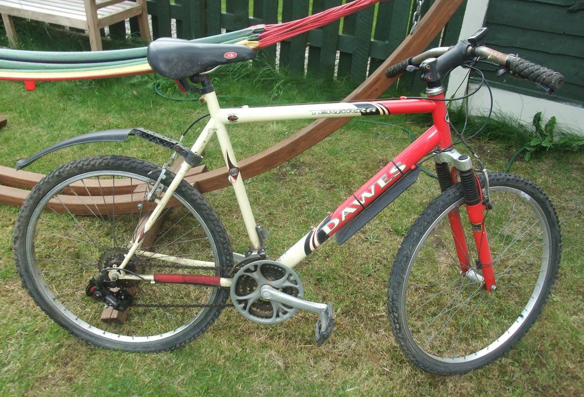

- Cleaned my Dawes Tekarra which is about to be put on eBay at 99p starting bid and swapped the Ice Spiker Pro tyres for the ones it came with along with the original pedals. It's a cheap, tacky MTB and I've no space for it. Time to go ...
